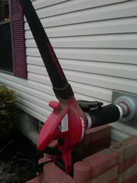

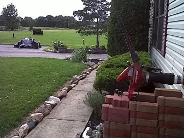

Yep. Do all that and Still use the leafblower. If you have never done so, you woulkd be amazed at what you miss. Even doing a full teardown of exhaust, blower, full exchange system cleaning, etc..
Anyone who has tried it will tell you.... You wont go back.

Yes it is worth doing. I've come in behind guys who clean stoves for a living (with out the use of a leaf blower/vac) and even after they remove all the motors and clean all the nooks and crannies I still get dust being sucked out. It really gets air back into the places you can't reach by hand. Do it, you'll be happy you did.
