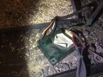

Pic of the controller: IPI system, pilot lights but no gas.  No volts on green wire
Little bare wire in the pic is my probe.

I didn't - saw that suggestion though. The valve itself is buried under a cover attached to the whole burner unit. I guess I could lift up the whole thing and bang it from underneath. I went ahead and bought a new controller. The melted casing and some intermittent cutouts last season pointed to controller problems but the kicker is this:
My multimeter read the green wire as open-circuit / open collector the whole way through the sequence. It was like the meter probes were utterly unconnected - not high or low, just floating. The pilot circuit was totally different - the meter locked onto a voltage through each stage. I know my way around electronics and the green wire just didn't seem right. Maybe one solenoid driver (MOSFET) burned out or desoldered itself while the other one was ok. Obviously the microcontroller inside is working or pilot sequence wouldn't happen.
The repair guy told my wife that parts and labor for a fix is the same or worse than a new unit for $900 to $1000. So a $100 controller that fixes the issue will make me look like a hero. Maybe it works, maybe it doesn't. If a new controller doesn't fix the problem I'll try the "tap" and ask Amazon if they'll take it back (50/50 there I think). In any case I'll know I didn't get suckered into a new burner without trying to fix it myself. Monkeying around with gas lines in a valve swap is probably beyond me anyhow, so if the controller doesn't fix it and the "tap" doesn't fix it I'm not out much compared to the cost of the new unit.
