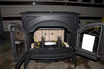

velvetfoot said:Those pumice bricks are crap. I've had two Quads with them, and they just peel away in a very short time. I recall someone said that Quad says that they can lose half their thickness and still be within 'specs'. Yeah right. I replaced both sets of them with the heavy brickyard fire bricks.
Mine are 8 or 9 (can't remember) and doing fine.TMonter said:Just FYI my quad has the original set of pumice bricks save one which broke from me dropping it and they are 7 years old.
I remember the threads when you were looking to buy the stove. How's it heating? I'll have to look up your posts to see how it has worked out. Sure is a nice looking stove!Chrism said:when your going to bed do pack the crap out of it ? what your over night burn time on yours?
Sounds good. I hope you get to use it this year, otherwise you'll have to repaint it next year after all the drool damage! :lol:Chrism said:Well haven't hooked it up yet I'm redoin the whole thing wire brushing everything, new fire bricks, new paint. I can't wait to hook that baby up. And I can't wait to put the before and after pics next to each other !!
