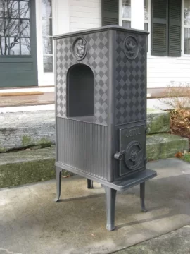

what size wood are you burning in this stove? length and split sizes?
and how many sq ft are you heating with it?

precaud said:Have burned both old and new 602's, and found optimum wood length to be 13"-14" and 3"-4" across. If it's a new F602, it likes some space in front and in back, and make sure you leave some room between the bottom pieces so air can get to the back of the firebox.
Lynch said:so if i had 16 inch wood i wouldnt be able to load it to the top? b/c of the baffles (secondairs) and with 13-14 you can stuff it full?
raiderfan said:Would burn for about three hours that way before I had to reload. I was heating about a 700 sq ft, uninsulated, very drafty basement space with it. Had to run it hot, with reloads coming at 450*, to keep up with my space. Thats why I decided to upgrade to what I have now. I loved it, though!!
