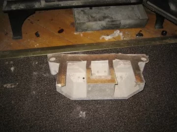

If this is similar to the ductwest the shoe comes out really easy, simply remove the ash grate and carefully side the shoe out. You must be very careful with the thin gasket between the top of the shoe and the surrounding refractory, I tore mine up removing it, and put it back without one. Once the shoe is out be very carefull of the very fragile material behind there, it is as delicate as stryofoam (sp?). Its an easy task, heres a pict.
Thanks for the pic! Did you find lots of ash behind/under the shoe? Was your stove running lazy as well?

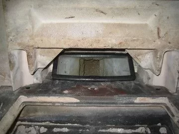

Well, my stove (med dutchwest) has always ran "lazy" with the bypass closed, I also thought it might be clogging behind the shoe, but everything was very clean and intact behind there. I don't know what my problem is, perhaps my extremely high elevation, perhaps I'm just inept at running the dog-gone thing. Anyways, I was scared to take it apart at first, but it really is easy, just go slow. As you remove the shoe, the gasket should come out with it, easy does it, dont pull it out fast like I did (I thought there would be some resistance...) with a vac, suck up as much as you can see and put it back together. I think you will know at once if it is your problem, mine was surprising clean. I got a mirror and put it up behind there to see what it looked like, you might do the same...here another pict

Thanks a lot for the reply. I will report once I am done (this aft.)

I am back in business!!!
The cleaning was a piece of cake as I was told. There was a lot of ash behind/under the shoe, practically blocking the front air holes. I broke half of the gasket (but no problem to run without it..apparently). I fired the stove & she's running like before nice 600* stove top & no idea what the pipe temp is since my other thermo. is stuck at 500* (hot or cold)!
