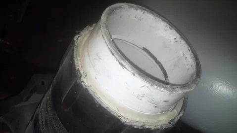

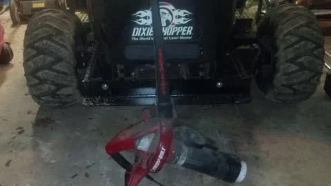

    I measured my O.D. and my I.D. of my venting and made a trip to the hardware store. I found a 4" reducer (from 5") and cut the vacuum end and Liquid Nails it in there.
    I also put a wrap of duct tape on, to make sure I get 100% of the suction through the vent.

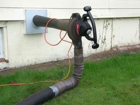

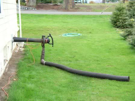

    Look for one with the highest volume of air movement. Hightest "CFM" (cubic feet per minute). It needs to have enough air movement to pick up all the fly ash and move it out of the vent pipe. My Electric Toro is rated at 390CFM.
    And as said before get one that you can easily adapt to fit your outside pellet vent pipe. My Toro gets a pretty good seal on my 4" vent pipe with it's standard attachments.
    I run a vent pipe brush down mine to loosen everything up before I pull a suction on it with the leaf blower.
    I get a little creosote and ash build-up on the outside end piece of the vent pipe and screen so I remove it and wash off the creosote with the garden hose and nozzle.
