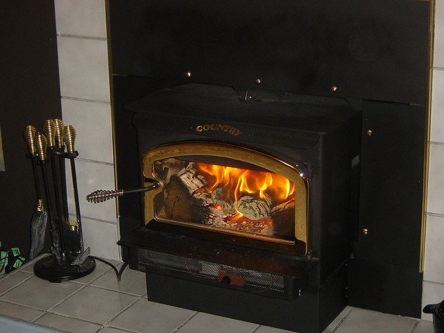

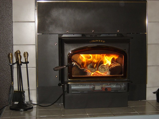

I have the Country C-210 and certainly can't complain; it heats my house perfectly. Prior to buying, I looked at Quadrafires as well and almost bought one (3100 model). But I have since heard horrible things about Quadrafires customer service (all heard here on Hearth.com), and am very happy we went with Lennox. I'm also not a fan of the Quads ACC system..... Keep it simple; especially when obtaining "service" from QF is questionable.
If I'm not mistaken (and I might be), the QF 2700 is a slightly smaller stove than the C-210, which you may want to account for when determing how much you want to heat, and how hot you want to get it.
I aided in our professional install, and it took the 3 of us a few hours. I had to use an offset box as well. Making the offset-to-flue connection was tight (vertically) and required a very long extension bit.
My vote is for the C-210, but your preferences or installation clearances will dictate your final outcome.
