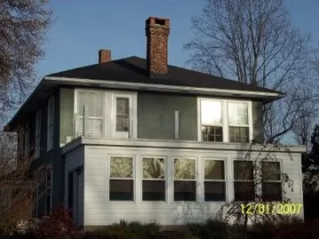

will be doing a reline of masonary chimney, about 25' high from existing damper. the chimney runs inside the house, on exterior wall and sticks out above roof by 6 ft. first floor has enclosed 3 season porch on other side of chimney. existing chimney has 8 x 12 clay flueliner from about 3-4' above damper to roof line, above roof is just masonary. thinking of using homesaver ultra pro ss liner. question is do you insulate the ss liner up to 1st clay tile and above roof or all the way? is it neccessaary to insulate all the way? appreciate advise and suggestions on liner type. check out pic on chimney.

Since part of your flue does not have a clay liner I would suggest you insulated the entire thing. At a minimum you MUST insulate the section without any clay liner. The problem is going to be getting a liner down the 8x12 (usually 6" ID at the narrow side) with insulation on it. We have done a few installs into 8x12 flues using DuraLiner oval rigid liner. It is double wall and pre insulated. It fits very easly down an 8x12 clay flue. Either way you will probably need either a 5.5" liner or an oval liner to get it down with insulation.
zanp: I actually meant for winter to post here and you to continue in your own post... oh well. Anyway... I don't have personal expiriance with those exact products but from the pictures and the info given it looks like it will work just fine. Make sure you use the 1/2" insulation kit as suggested on the site for solid fuels. With the two kits combined it looks like you would have everything you need to get it done. After the 1/2" insulation the whole thing will be over 7" (about 7-1/2") wide so make sure it will fit down your flue.
