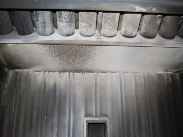

Eatonpcat...yours is an insert? My insert only has a partial baffle on top. It is screwed to the heat exchanger tube scraper. Seems to be quite a bit different from the freestanding models. I wonder which is better? Here is what it looks like on the insert...
You are correct...Thanks for clearing that up!!
