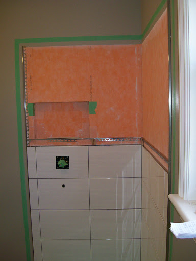

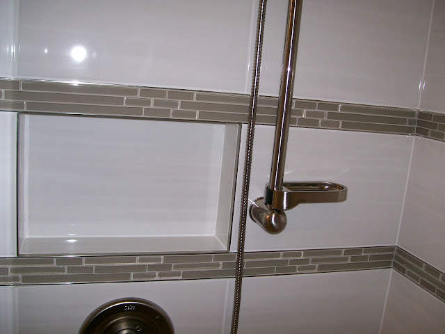

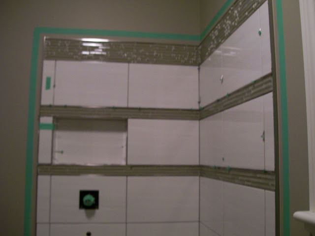

    Here is a progress pic of the shower stall. I've since finished the tiling but need to give it a few days before grouting.
    [IMG]
    The white field tile was set with unmodified but the glass accent tiles were done with modified.
    [IMG]
    The wife took the pics and they didn't turn out well. I'll take some pics after it's all grouted and the fixtures installed.

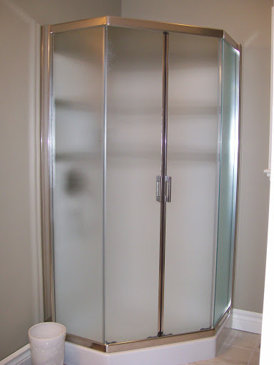

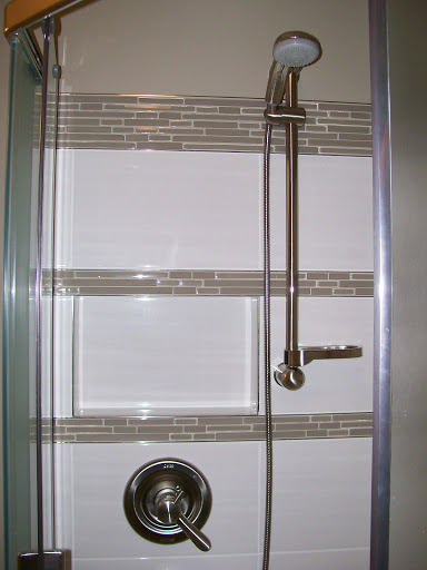

    Here is the finished shower. Maybe I should have chosen clear glass to show off the tile work.
    [IMG]
    Here's a couple of pics with the shower door open. The grout on the glass tile looks uneven because of the flash. Some of the tiles are clear glass and others are matt and the flash affects the clear tiles differently.
    [IMG]
    [IMG]
    The clear tape did leave some gummy residue but the white grout didn't stain. Still waiting for the granite counter top and vanity to be delivered so I can finish the job.

    Looks pretty sharp there Lig. Nice work. Is that a Grohe relaxa shower? The shower head looks just like ours. Though I mated it with an American Standard valve set.
  14. LLigetfa Minister of Fire
    joined: Nov 9, 2008
    7,310 posts
    NW Ontario
    The shower base and doors are made by MAAX, the control is a Delta Monitor 17 series, and the wall union and shower bar are JL Baril. Seeing as I hate to have water flow restrictions imposed on me by some government body, I found and defeated the flow restriction device in the head and connected to the unrestricted tub filler side of the control instead of the restricted shower side. I have yet to run any water through it to see if it can peel skin.
    You cannot see it in the pictures, but I had to make a 1/2 inch thick escutcheon for the top mount of the shower bar since the wall tile comes out 1/2 inch from the plane of the wall above the tile. I found a stainless steel measuring cup that matched in style and finish and cut the bottom off with a skinny disk. It looks just like it's a part of the fixture.
