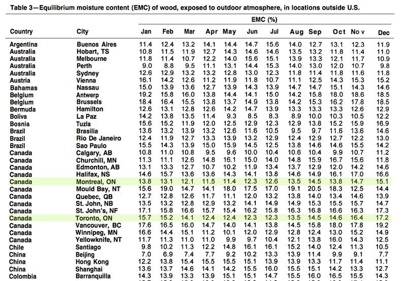

MapleLeafCityBurner said:If its over 20% MC then you'd want to refuse the delivery imo. Optimal burn % is pretty much as low as you can get it, but anything under 10% seems to be a magic number. So if you get seasoned wood from a supplier at 18%, you know you should let it sit another year before using it.
Battenkiller said:MapleLeafCityBurner said:If its over 20% MC then you'd want to refuse the delivery imo. Optimal burn % is pretty much as low as you can get it, but anything under 10% seems to be a magic number. So if you get seasoned wood from a supplier at 18%, you know you should let it sit another year before using it.
That's pure silliness. I defy anyone here to show me an internal MC reading of less than 10% using an accurate meter in wood stored outside for any length of time. In particular, you could store wood anywhere in Ontario for a thousand years in an open shed and it will never drop below 12%MC.

Precisely. Wood is hydroscopic,it takes on whatever humidity is in its immediate surroundings.No wood is ever 'truly' dry.I've seen beams & rafters in various castles,cathedrals & bridges in Europe that were 800 or more yrs old in some cases.They're never less than 10-12%,could be high as 20% if near a water source or the coast.Here in Iowa,any air dried wood you find,even 150 yr old barn timbers are never less than 10% even inside dry winter heated buildings,most what I see is 12%,occasionally 14% in humid summer months.
