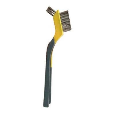

I use something that looks roughly like this

I don't know if it was obvious, those are stainless steel bristles.

I just bought a toothbrush style wire brush to help clean the tough spots. With your experience should I be worried about excessive wear when using it? Is it even possible to damage the firepot, baffle, and heat exchangers with the wire brush?
It should not be a problem. I scrub the fire pot with the wire brush and I have been using on the heat exchanger as well. No signs of wear of any kind. I have even used a wire wheel on the fire pot. Just be gentle around the thermocouple cover.
