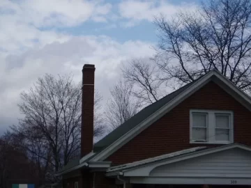

I'm a bit concerned about lopping of some of chimney. The rule is that "chimneys shall extend at least three feet above the highest point where it passes through the roof of a building, and at least two feet higher than any portion of a building within ten feet.” At this point I don't understand why they built the chimney with an extra 4-5 ft. if it wasn't required. If there are multiple roofs, perhaps they made it taller to avoid downdraft? Can you post a shot of the current chimney or describe it's installation in more detail?

Here's a pic of my chimney

Wow, you don't see that too often around here in earthquake territory. I'm surprised it isn't braced. As long as you follow the rule, it does look like the height could be reduced a bit.
There is no way you'd get me up there. No sir.
Wow, that is quite a chimney!!!!
You'd need a helicopter or a crane to do a chimney sweeping on that one. Maybe you could go on Google earth in a few years and get a look down it to see how much creosote is there!! LOL.
I wouldn't even want to lean a ladder on that for fear that it's just a stack of loose bricks.
See what I mean about not wanting to clean this myself? If you think this one's something, you should have seen my other one I just had tore down over the weekend! Just as tall and was missing LOTS of mortar, really don't know how it was still standing. Believe it or not the guy that swept the one in the pic said their was hardly any creosote in it at all. At least this one only has a handful of joints that need some mortar so I think I'm going to downsize it as much as possible using the 10-3-2 rule.
