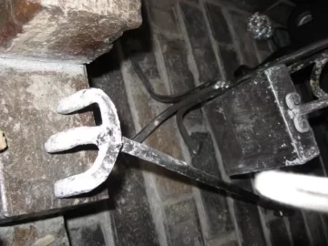

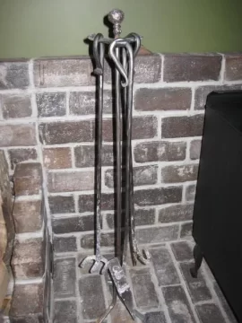

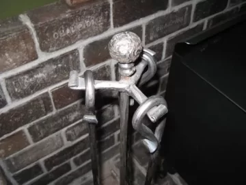

Of all the tools I have made for my stove(s) this is by far the most often used - daily - to move ash around and coals forward to load stove. When I want to get rid of ash I just take a few scoops out from the front prior to moving the coals around and they quickly go to the fire pit outside. I have also taken out the plug and replaced it with a fire brick. I think if you choose to leave the plug in for the season you will likely get more controled burns and burn time if you fill the ash pan and leave it full all season. tools 002.JPGtools 003.JPGtools 005.JPG
