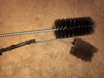

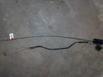

  3. Justin M Member
    joined: Dec 22, 2008
    158 posts
    Southbury, CT
    So I got a new brush from Grainger. The twisted metal rod is much thicker/beefier so I think it will do the trick. I will update after the next time I clean the stove.

  7. Justin M Member
    158 posts
    Southbury, CT
    So I cleaned the stove because I wanted to try out the new brush. I was able to push it all the way through the exhaust path. It took a little forcing to get it through. Unlike the harman brush which was too weak and would bend on itself, this one was almost too stiff to make the 90° turn. So it definitely works, but I still think there is probably a better way. Maybe I will get another length of hose and try the previously mentioned vacuum method.
