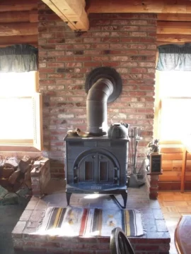

Current Heating Sources: Propane central heating furnace with ducts to every room in cabin. We don't want to use this system at all, if possible. 1st floor has a Phoenix pellet stove which does an adequate job of heating the 1st floor. 2nd floor has a 1981 Dutchwest India wood stove Model FA264CL. (This is the stove in the pictures and the one we want to replace. The heat shield at the back is degrading, the grate on the bottom is burnt through, and we cannot get parts for it.) There is also a Heatilator Mark 123 fireplace on the 2nd floor. This does not provide much heat to the floor and we don't use it much. Only propane furnace central air system currently heats 3rd floor.

Pictures:
The pictures that I have attached are only of the 2nd floor where the stove will be located. The pictures hopefully give a good idea of the install location, the 2nd floor rooms, and the stairs leading up to the third floor.
