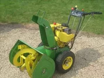

    We have the JD 826, the best snowblower I've walked behind.

    I can vouch for this, I have one and its the best blower Ive ever owned, its never let me down and the only money Ive spent on it is regular maintenance.

    Deere hasn't built their own blower in decades. Even the old blowers like the one Zap has, they are awful similar to a Bolens of similar vintage. The Deere's have far nicer contol setups tho.
    I'm guessing you used an 1132D or similar. Those units were built by Ariens (similar to their professional series units) and are indeed some of the best to ever wear the Deere name.
    Have you tried increasing the speed of 1st gear slightly? These type of drives (almost universal in snowblowers) don't perform well if 1st gear is too close to the center of the drive plate. The problem is aggravated if the driven wheel (donut) is worn flat across the rubber face. Should have a bit of crown to it.
    Zap, I'd love to score an old 1032 from the same series for a decent price. Nothing seems to stop these units. They may not throw 50 feet like the newer units but they just keep digging.

    The mechanic at the Wood Chop Shop told me the 826 was built by Ariens for Deere.
