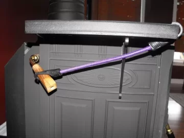

Damper is working so far as I know. The only problem is that when it is in the closed position, if a pressure drop occurs or if the stove whuffs, it will blow open the damper. That creates a dangerous situation of a run away fire, especailly if we are asleep or away from home. So we use a bungee cord to keep it closed. See attached. The handle is one I crafted after the factory one fell apart.
