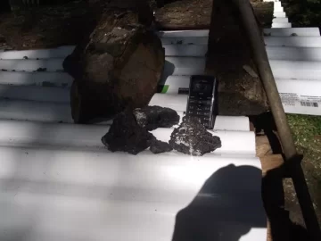

    I don't know the configuration of the Oslo but this is what I found above the baffles on my Jotul Rockland. Had excellent draft when first installed then found I sometimes had to use a hair dryer to get things going. Had the chimney swept before the season started and after getting this stuff out of the way I could start a fire w/o problem if it 70 outside.
    The issue of course was the quality of the wood I was burning (18 month seasoned locust). As I learned from the collective wisdom here, wood can't be dry enough. Oh no did I start the too dry controversy?!! :)
