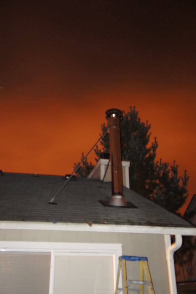

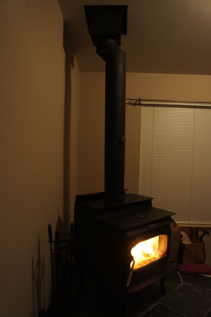

I just plumbed in the OAK today and started a fire. In the past I left the door cracked and the smoke would go right up the flue no problems. Now with the OAK installed smoke started leaking out the door so I had to close it. The fire didn't get going as fast as with the OAK not hooked up.
I've got the Lennox Performer 210 with 4 ft of double wall stove pipe then 2 45 deg's back to back and then 8 ft of chimney. The mfg say's 12-15 ft of draft but the shop i got it from said the stove will draft just fine with what I have.
I do not understand how the OAK makes the differences; I know there is one though. Do I need a few more feet of chimney?
