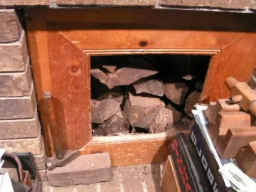

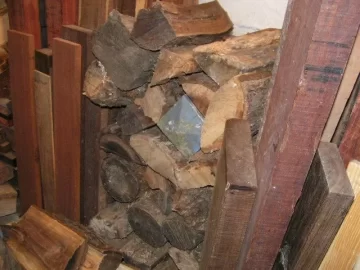

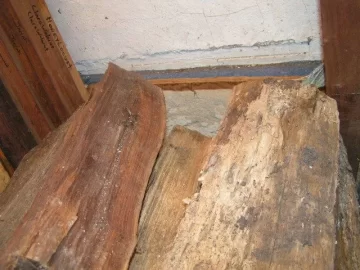

Pass-through woodbox in basement family room,approx 3' x 3' square x 2' deep opening in hollow claytile non-load bearing wall in walkout basement of 85+ yr old house with 2 car garage underneath.Other side of wall where hinged door is in garage/shop there's room for about 3 times amount on floor.I can get roughly 2-3 days storage total.Not much more cause I need room to walk or climb around lumber stacks.

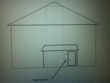

Here's my initial plan to build on the back side of the house and enclose the wood pass thru.
The 'shed' should hold about 90 - 100 cu ft (3' x 5' x 6') of stacked wood aside the entrance way, keep it dry and provide a sheltered
enclosed area to load the inside storage bin next to the fireplace.

I'd put about 8" of gravel in for a floor with a 4" pipe coming out of it headed downhill.
