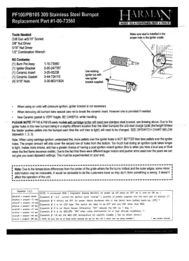

Hello. Appreciate all the helpful info in these threads. When my pf100(2534) lights off,(coil igniter), there is a violent boom. Some backstory. Stove about 9 years old. On and off been lazy and used the propane furnace to heat our house. So maybe 6 years of service. Maybe 2 years in,pot bubbled. My local dealer would not warrenty. said it had to be cracked. Next year it cracked. Put new burn pot on. (old style). Cracked and bubbled again. Have been running it like this for couple of years. didn't seem to hurt anything. Until.....
Now. When it lights it booms. I am guessing,because of the pot bubble the pellets are not lighting in a timly manner. And when they finally do there are lots of wood gases all catching at once.
So I need a new pot. My question is, will Harmon send a new one free because of design flaw? Do i really need the newly designed pot? It is $500. A lot of money. Could i find an older style pot? Used? Can i mess with the dip switches to get it to light less violently until i get the new pot. Any help would be appreciated.

You could try adjusting the amount of time that the feed auger runs for start-up. You would want to set the run time shorter. Eventually, you will probably need to replace your burn pot.

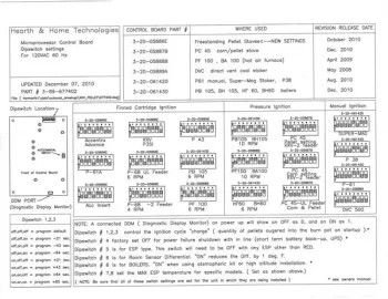

Thanks. I lowered the feed rate to one. Thinking along the same lines. Wasn't sure of the relationship of feed rate and the dip switches. Maybe the dip switches overrides the feed rate setting for the initial burn?
Since i set the feed rate to 1 i have not heard the stove boom.. Last night i observed a cold start. After a few minutes it light off pretty smoothly. But i quickly opened the door to look at how full the pot was. It was full to the brim! What the heck. My dip switches are set to off, on ,off. According to your info it is -43. But some of the setting are + and some are -. Little confusing. Shouldn't all the numbers be positive? I will change the dip switch setting, cold start it, let it feed. Then see how full the hopper is. And make a note.Thanks again. Farmer.
The numbers are values +/- from the programmed auger run time for initial startup. I see on another sheet that I have, that the default settings for the PF100 are on/off/on for dip switches 1-3. Which is to set the auger to run for 43 seconds more than the programmed time. You currently have your unit set to off/on/off which would run the auger for 43 seconds less than the programmed time. If your burn pot still is filling over 2/3 full, try setting your switches to off/on/on to set it to run 64 seconds less than the programmed time.
