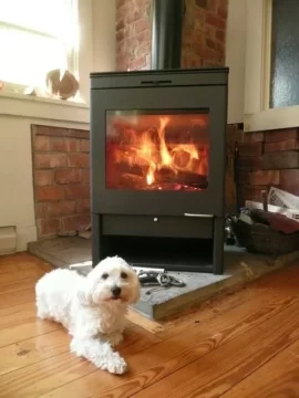

Pineburner said:Nice looking stove! huge view of the fire! hearth seems to be a little short in the front, but could be the way the pics portray it.
Gunks said:Here is a picture of the inaugural fire of the new Scan 60 stove. It was in the low 40's yesterday morning. Just cold enough to light a fire for the picture.

Beat me to it what kind of stove is that in your avatar? And the dog likes new stove as much as old. Nice job enjoy.

I like your new stove, Im a fan of the comtemporary look, does it come in a bigger size?
