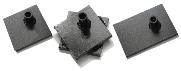

Has anyone ever priced this? I've often wondered what they charge for doing this...
Here they are.
