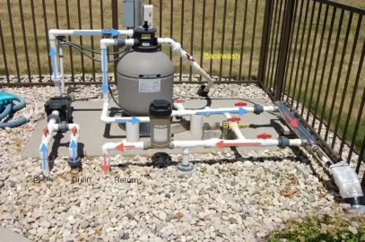

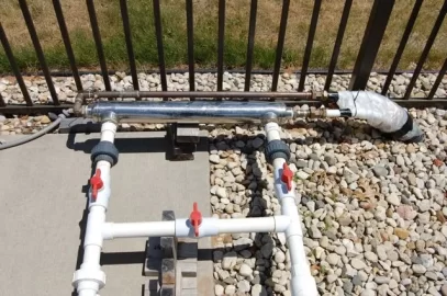

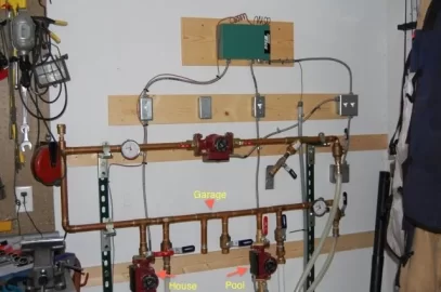

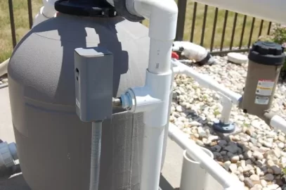

    Here are a few pictures.
    I have bypass valves for the exchanger.
    The aquastat is wired to a Taco circulator Zone controller in my garage. I have a Primary/Secondary manifold in the garage. The Primary pump is wired to run on demand for any call for heat from the secondary loops.
    The red valve that is near the bottom right of the sand filter also goes underground to some home made solar loops that I have.

    One aggravating thing about installs these days is that Manufacturers don't seem to take the time to make things plumb, level or consistant.
    The heater ports on exchanger are not even close to being level with each other. It makes a straight plumbing job impossible off the exchanger.
    I had the same problem with my Econoburn Boiler. The supply outlet on the top isn't even close to level with the boiler top....frustrating.

    The bypass valves you are talking about, are they the ones I see or do you have bypass valves for the exchanger off the primary manifold?
    Is it a primary manifold or a loop?
    Trying to figure out the flow. Looks like the pump is pulling water from two locations. Why? Then filling the filter where it comes out and flows to the exchanger and then to the chlorinator and out to the pool.
    Where does the pipe go right before the chlorinator? Never mind thats just a stand.
    The pipe coming off the top of the filter and going under ground ... is that a backwash pipe? Because the valve is open.
    Can I see a pic or two of the primary loop in the garage?
    How do you have the storage plumbed?

    Here are some pictures that should answer your questions about flow.
    Both the Boiler and Pool water can be bypassed
    The Manifold is in My garage about 45' from pool exchanger. In time I might replace the manifold with a 150-200 gallon hydraulic separator style buffer tank or stopped with valves.
    My boiler and storage are 115' one way from the manifold in my pole building.
    gg
    . Primary:secondary.jpg poolheaterflow2.jpg

    Are those temp gauges or pressure or both?
    The manifold flows counterclockwise?
    The pex line on the top right is the supply from the storage?
    The two pumps push hot water to the loads?
  9. goosegunner Minister of Fire
    joined: Oct 15, 2009
    1,078 posts
    WI
    Thanks
    Both temp and pressure
    Counterclockwise
    Pex supply on top return on bottom
    Loads are supply left, close T return RIght
    gg
