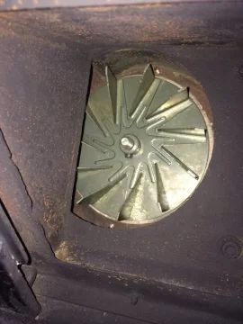

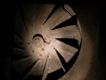

Hello
I did this to my Contour and ran it all last winter and it worked super!
The pellets always lit because no stuck ash in the fire pot!
Anyone try this?
Pic 1 - Standard quad large 9 petal blade
Pic 2 - upgraded quad large 11 petal blade

Yes, but the pellets seem to burn more completely.
The speed the stove uses is the same because the RPMs are the same.
Just IMHO, there needs to be an optimum air to fuel mixture which is harder to achieve on lower heat levels and this seems to achieve that. :)

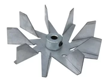

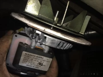

More Pics
New Impeller Blade fits and runs perfect!
Stove is ready for another harsh snowy cold winter season. :)

Very Good. -- On the motor tag, what is the AMPs of your motor?
Mine is now 1.75 amps for good low drafting. :)
0.54 but that's the electrical current rating of the motor windings. It's only a 35 Watt motor. I think I measured 25/30/35 Watts (on Low/Med/High) a few years ago, fwiw.
Wow that is very low! Do you get any ashes in the firepot that stop the stove from lighting up? I hear that is a common complaint. I am hoping to cure that with the higher current blower on the large blade impellers.
Nope, no ash problems in the burnpot. It lights up just fine.
I'll re-phrase it... the Amp rating is what the motor's windings can handle. It doesn't mean the motor will necessarily draw that much current. If that blower ran at 1.75 Amps, it would blow out the fire and probably fry the control box.
