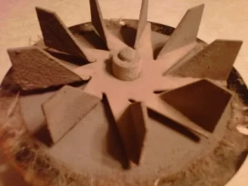

DexterDay said:I have my Combustion Blower out right now. The pic is from a cell phone so you can't see the "build-up" all that great, but its there.

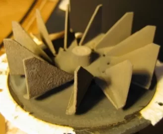

imacman said:DexterDay said:I have my Combustion Blower out right now. The pic is from a cell phone so you can't see the "build-up" all that great, but its there.
Dexter, how many bags burned through the stove since that blower was last cleaned?
Look about the same?? Mine might have a little more on it. Are you burning on on lower, or Medium setting? I know Englander's have 5-6 settings? (I think). I burn on the Low setting 90% of the time. Only go to medium when it gets around 0 outside.imacman said:This was my Englander after 60 bags:
Without truely taking the blower out, you can't get behind the fins and the get it really clean.. Prob easier to Ding the fins up without having it in front of you. I clean mine thru the clean-out plate on the opposite side every week also. But it still gets 1/4" build-up behind the fins after only 2 ton. Something that needs to be done, at LEAST once a year. IMHOHank Hill said:I take mine apart everyweek. But I dont remove the blowers manually, I do keep them clean though...
DexterDay said:....Something that needs to be done, at LEAST once a year. IMHO
DexterDay said:.....Are you burning on on lower, or Medium setting? I know Englander's have 5-6 settings? (I think). I burn on the Low setting 90% of the time. Only go to medium when it gets around 0 outside.
