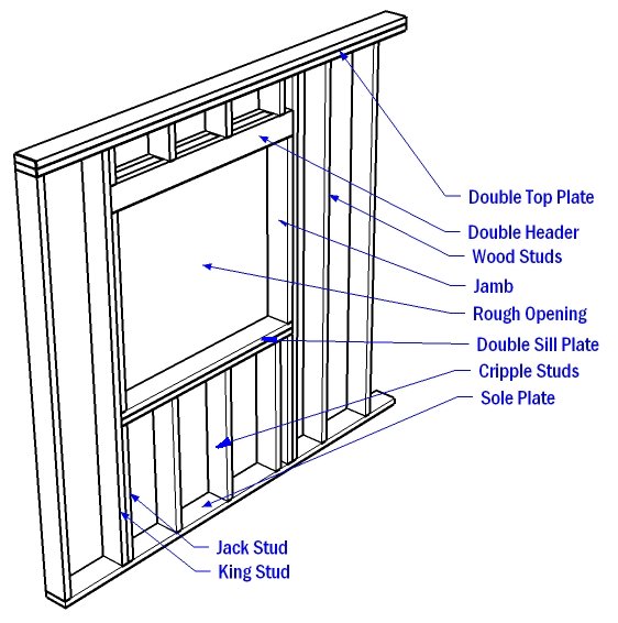

    What does the paperwork for the thimble say about clearances? The thimble I installed had more than 2" CTC on each side of insulation alone! If I remember correctly it took a full 15" bay, but used stainless single wall instead of double wall.
    If it is through the wall, you shouldn't have any problem opening it up for the thimble. The process is no different than if you called a carpenter and had them install a window in the middle of a wall.
