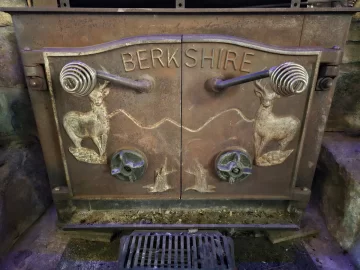

Hey everyone! Anyone here know what kind of silver paint for the raised castings of deer. etc that I can use for this BIG old stove/insert? thanks!?
Could those areas be polished after the stove repaint?
Yes paint it with stove Brite paint. I think they have a silver as well. If not header paint from the auto parts store works
I do not know... should I paint I though?... I was just going to wirewheel that rust off
Yes, definitely paint the stove. It will not only look 1000% better, it will also inhibit further exterior rusting.
