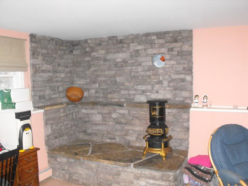

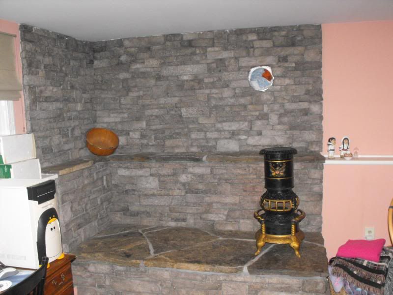

well here is a couple pics. i can put most anything i want there. i have a hole outside that accepts an 8" pipe. the desk and rocker will move. the floor is tile. not worried about clearance to combustibles. i have burned here before. i used a hearthstone soapstone stone. i loved the ease of the ashpan. i had a stove without and the bucket and cleaning shovel sucked. not for me. makes toooo much dust in house. i have eyeballed those cheetah ash vacs... i imagine those might work well. but never had the oppertunity to use one.
well i cant seem to post pics tonight ? ...never had a problem before. anyway its a stone raised heathh about 6ft wide by 2 ft deep, floor to ceiling

Mike I didn't see the pictures of your hearth first time I looked at this thread. It looks great!, and I like the idea of a raised hearth, but because it is so high and your ceiling is low you might have some clearance issues between the ceiling and the top of the stove with some stoves, make sure you check that out before you purchase your stove.

yeah , had trouble posting from photobucket at first. switched folders and was good to go.
the door for the ashpan on the heritage was built just like the loading door. had a rope gasket and was just as tight.
as far as combustibles goes, the floor is concrete, capped with tile... the hearth was roughed in with cement block and faced with faux stone and the cap stones are native flagging stone. not worried about any of that catching fire. it is 6ft wide x 2ft deep and the top of raised hearth is 19" high. cieling is 84" high , so 65" from top of hearth to ceiling. not sure what the top height is on some of these stoves but even if we're talking 30"-35" ,.....that still leaves me 30"-35" to ceiling . not sure what the newer stoves require for clearances to combustibles.....i'm sure it depends on btu output. i know my heritage was 18" to combustibles. it was also probably close to 1/2 the btu output of some of these stoves you all mentioned
also, not to get off the subject, but the old oil heater in hearth photo....i'm trying to find out about it. it says "the eagle 10" on it , that's it, nothing else anywhere. if anyone knows anything about the history of this heater i would love to hear from you...

[quote author="mike in ct" date="1301069921"]still leaves me 30"-35" to ceiling . not sure what the newer stoves require for clearances to combustibles.....i'm sure it depends on btu output. i know my heritage was 18" to combustibles. it was also probably close to 1/2 the btu output of some of these stoves you all mentioned
Not that you are considering it, but, the PE Alderlea's have ~55~" model dependant stove top to ceiling clearance. Read closely any specs when you narrow down your choices.
Also BTU output and clearances are not related, stove design generally dictates clearances
