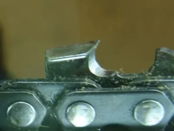

Never hear of square filing a chainsaw chain. I'll have to pay a little closer attention to the factory angles when I get it. Do you have to use a different type of file?
HittinSteel said:Jay, I can't sharpen RSC with a round file?
HittinSteel said:Learn something new everyday. I'm almost out of round files, so maybe I better get some square!
It is and the files are more money as well, But if your really good at round fileing it comes pretty quick.oldspark said:Square filing is a little harder to learn correct?
wendell said:Jay, you are the Stihl expert but the RSC I buy is round ground. Maybe the confusion is some Stihl people call full chisel square ground and semi chisel round ground. I know they did at the store I bought mine at.
Square filing is HARD to get right and most people I know who have tried have gone back to using a round file.
