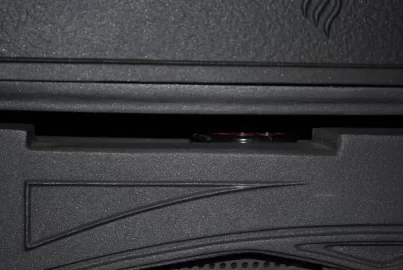

For most inserts, the best place to measure is in the air chamber. I don't know the T-5 so I going off of other inserts. The bottom of the air chamber is the stove top. The top plate of the chamber is not where you want to read. There's enough a gap to put a temp gauge or get an IR reading. If you look directly in the chamber with a flashlight, you should see the stove flue running through it.

See the gap where i have the thermometer? This is where the air exits the stove from the blower. I would think most inserts have this setup where you can see the stove pipe in the rear of this chamber. I can see mine when i shine a flashlight in there.
Stejus-Thanks for the input...I will have to take a look at it when its installed to find out more about it. The manual doesnt show very much.
