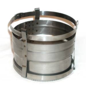

http://www.chimneylinerdepot.com/store/684/product/6-inch-Flex-Liner-Coupler.html
I've never used one of these, so I'm not sure how much (if any) lenght it would add, but it's an idea if you are willing to cut the current liner, then piece this in. Or perhaps you have a piece of liner left over? Or someone could get you some? Then you could use this to add a small piece in.
