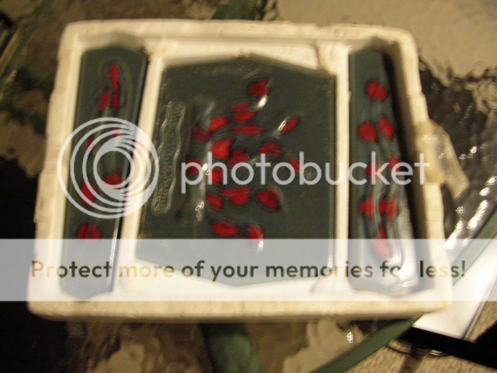

    I've seen that. The rep at the cat vendor had some concerns about the process. He wanted me to follow up with him after I had it out and we could look at it. He didn't seem to be a fan of soaking and if soaking wanted to be very specific about how to do it. I'll post another thread after I go through it with him. At $250 a pop, I'm more than happy to be patient and listen to every detail to prevent damage.

    interesting. ill be curious to see what his ideas are for cleaning it. your old cat looks like if you get it clean it may still work pretty good.. curious to see, when will you try the old one out again? i wish i got the combustor from the site you got it off of instead of condar. that thing was a pain in the ass to get in. and don't look forward to taking it out.

    This one slid in like butter, snug but smooth. I'll clean it sometime soon but probably won't use it anytime soon, maybe Fall 2013? Structurally it is perfect, so I think it will perform well after cleaning. I also now know the stove other than the cat is performing properly. I've got somewhere around 20 cord through it and who knows what the original owner put through it, I know it wasn't pretty. Thinking between the two of them, I may not need another combustor for at least a decade.

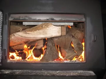

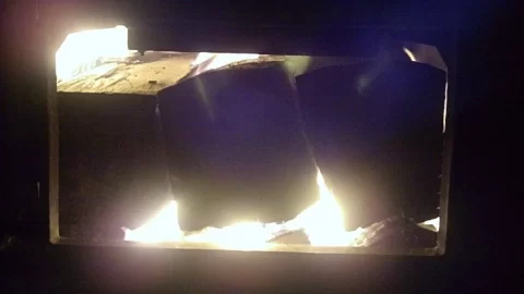

    Are the chunks and uglies bigger than the splits? Best light show I have had by far was this load running 3 - 3.25. Not one flame in the box. I like the 4-3 formation.

    those look like some mommas. no my chunks and uglies are pretty small. ive been splitting them small so they dry fast and light up nice. still get easy 12 14 hour burns with the mild weather were having.

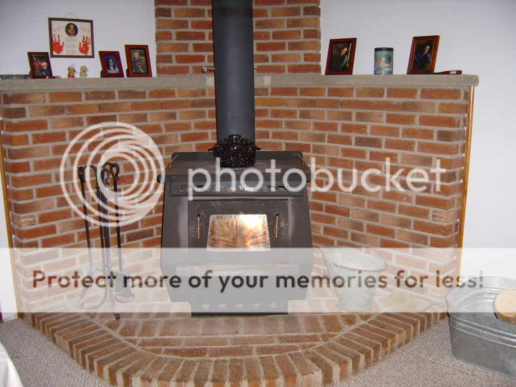

    Just found a pic of my old BK.
    The air used to come out between the top and above the door..that was pretty cool.
    Had the glass and solid door.[IMG]

    Don't go getting all sentimental now. What did you do with the stove? That beast would be perfect for our camp.

    thats looks like a wood eater. lol sweet pic
