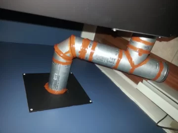

I did a corner install, through the wall...with standard Duravent 3" piping...45 degree angle straight out the house with a cleanout T on the outside. The Timberwolf's exhaust height is 17" to center. Some of the stoves I'm looking at, the exhaust is quite a bit lower. Example, a Quad CB1200 exhaust is 8-1/16" to center. My question is how do I get the exhaust up to the existing hole I punched in the side of my house? I would hate to have to patch the current hole and cut a new one. Any thoughts/ideas? Thanks.
