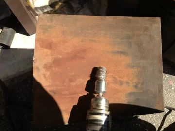

    These P Series Harman ash pans can get dirty and a little rusty so here is what I did.
    I pulled out my exacto knife kit and down loaded a nice camp fire stencil from the internet. The camp fire imples to use caution when empting the ashes. :)
    Went to the auto parts store for VHT Flame proof very high temperature Flat Black and Flat Aluminum car header paint. 2,000 Deg stuff not the 500 deg engine paint!
    Then I knock down the rust with the drill and wire brush. Cleaned it up with some Acetone from Home Depot!
    I printed out the stencil and cut out the inlay with the exacto knife.
    Painted the handle and the inside of the ash pan with the black and outside with the aluminum.
    Taped the stencil on and gave it a spray with the black over the aluminum.
    See pics

    Where is the finished product??
    The last pic isn't the finished pan?
    More pics...More pics... ;)

    Yes, it is
    Lighting is tough, here are a couple more.

    There was paper or something on the last pic in 1st post.
    Those look better. But isn't the pan hidden behind a door?
