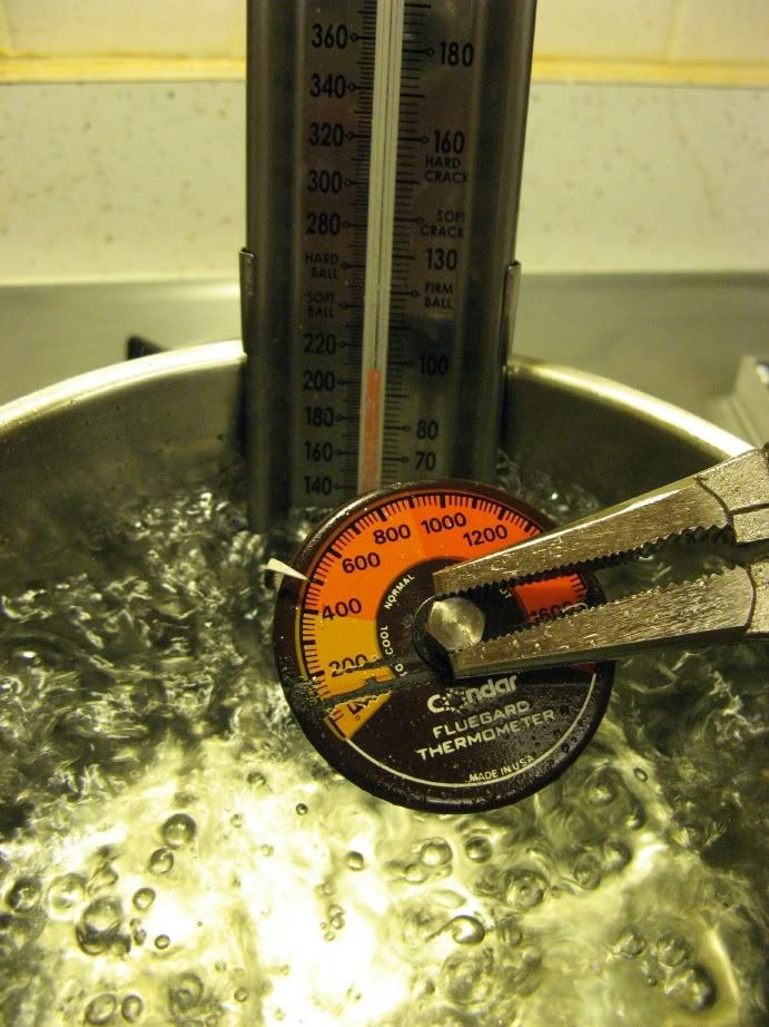

one way to check how acurate the thermometer is, would be to place it in boiling water and adjust the pointer as needed to read 212 degrees. We've had good success with this in our store with some of the problem probes
Like this?
Or this?
I sent these pics to condar and they didn't feel that they accurately depicted what was happening w/ a probe in a stove setting.

i've never seen a probe out by that much. To my thinking heat is heat as to where is comes from it doesn't matter. We usally put the probe and a meat thermometer in a large coffee mug with boiling water and compare the two
