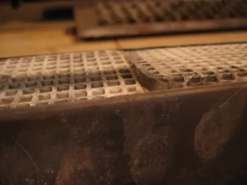

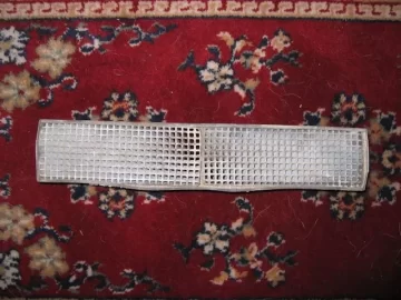

I inspected my catalytic element today and saw that it looked out of kilter. So I pulled it out and one half of the element is warped and not set in the metal frame correctly. The element isn't moving when I push on it, but perhaps under heat it would.
I've attached a thumnail of the problem. Is this element still OK to use? I don't see any cracking or crumbling, but I'm tempted to swap it out because of the warpage. This is my third season with this element. I burn 24/7 during the winter months. Thanks.

I'd replace it. You have it out and it is questonable. The combustor makes a big difference in wood use and creosote production on your stove. I'd buy the best converter I could get and be done with it.
