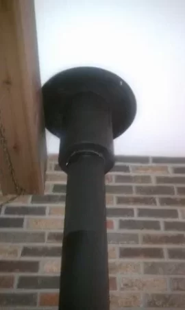

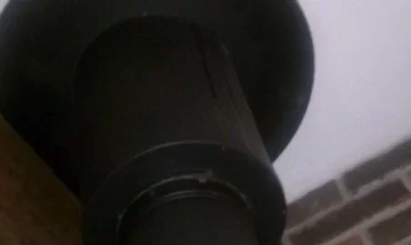

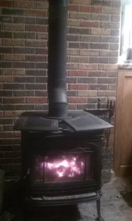

BG- I attached pics of my set up. The last pic is a close up of where the water was leaking.

OK, that helps. What was confusing me was the thimble term. Usually that refers just to a through-the-wall pipe. How is the chimney pipe supported?
I hate to make you head up there again, but if we can see what is up on the roof we should be able to spot errors. While you are up there, take a look at the seal on the storm collar and make sure it looks good. BTW, is this Metalbestos pipe?
Is that wood beam as close as it looks to your stove pipe? Sorry for going off topic.
