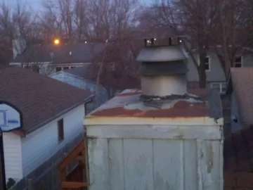

would be a bonus. Any pictures would be awsome. I will throw a picture of the ugly ass chimney.
I am residing it and having a new cap fabricated, and yes that is OD 14 inches standard for the mark 123s.
The old owners complained it would never draft right, and it showed when we painted the ceiling lol.
