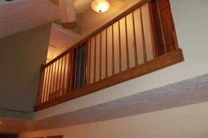

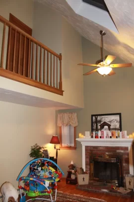

    1-30-2013 011.JPG 1-30-2013 012.JPG Hey guys I am Halligan's friend the one who is looking for the insert. We recently bought this house and the bill to the oil man is painful and frequent. We enjoy the fireplace, and I know there is $$ going up the flu every time we decide to enjoy a fire. The Square footage is @ 2,000 and we are willing to pay $3,000.00 for the insert and then the associated cost for installation. I provided some pictures to show everyone what I am talking about.

    Heating with wood is a lot of fun, saves thousands of dollars and can get addictive. A few facts that may help guide your search for an insert. You will want to install a stainless steel liner from the unit through the chimney and all the way up to the chimney cap. Based on the picture that looks like an outside wall so you will probably want to insulate that liner. Keep this in mind when you budget.
    In Rhode Island you may want to look at something around 3 cf in firebox size. I know Halligan provided us with measurements, do those measurements factor in a taper in the fireplace? If the current fireplace is tapered in the back, it will limit which units fit in there.

    Welcome seaboss! Thanks for the pics. You have a lot of options with that set up. Don't know what else you need to heat on the main level, but it looks like you need to heat that main room and the up stairs. I had an old Avalon in my previous house and it would burn about 600 degrees stove top temp for 4-6 hours. It heated the upper level to 80 degrees and the main level to 72. I had to use fans to move the heat into the rooms, but it got the job done. When we moved into our current home I wanted a CAT stove for longer overnight burns so I decided on the blaze king princess insert. I have been very happy with the burn times and the heat output. You will quickly learn everyone is very particular and passionate about their stoves! As a wise man once told me, "no one likes for their baby to be called ugly!!!" So, get what fits you and love your baby!
