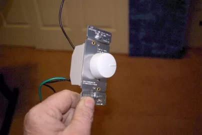

OH, here is a Piccy of the needed fan speed contoller
This one is marked FAN ONLY
There are light dimmers and fan speed controllers. Be sure to use a fan speed controller
Just another tid bit here, turning the knob all the way counter clockwise it will "CLICK" into the OFF position. If you wire this controller in directly to the L1 line be sure to install an inline fuse ( 5 amps max)
You will need to turn the fan on and off with this control as the board will not do it.
Any questions, just ASK

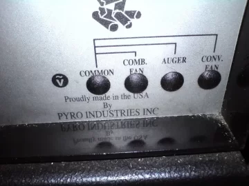

In order to leave out a wiring/bad connector issue you could ask your friend, who is an electrician, to bring a voltmeter... you see, the output voltages from the control board to the auger motor, room blower and combustion blower are all very service friendly accessible underneath the nylon plugs on the front of the control board. See pic below.
With a knife they can easily be prised out, but... remember to put them back again after measuring, as they cover dangerous voltages.
If healthy voltages are present there, then your control board is also ok.

I had a chance to look carefully at the components again. There is a high temp switch between the auger and the main bus but that is it. There is what appears to be a jumper where there might have possibly been a pressure switch. But it is not there. Of course I didn't know that it was supposed to be there until I started fooling about with this thing. So it has evidently run just fine for the last 5 years with out it.
I am trying to determine the purpose of the pressure switch. If I understand it correctly, it shuts down the auger if the exhaust pressure is negative (meaning the smoke is not exiting)?? So the safety that it provides is that if your exhaust fan shuts down then the auger will stop the fire. Is it a redundancy of the low temp switch? Which will shut it down because the temp would go down with a smoky smoldering fire anyway??
Only asking because I have run this stove for multiple years without it and it seems fine. I am now going to be rewiring it and to be honest, don't want to invest pay for some lawyers CYA or a feature that makes it safer in a mobil home or a small space (neither of which apply to me). On the other hand I don't want to create a hazard.
