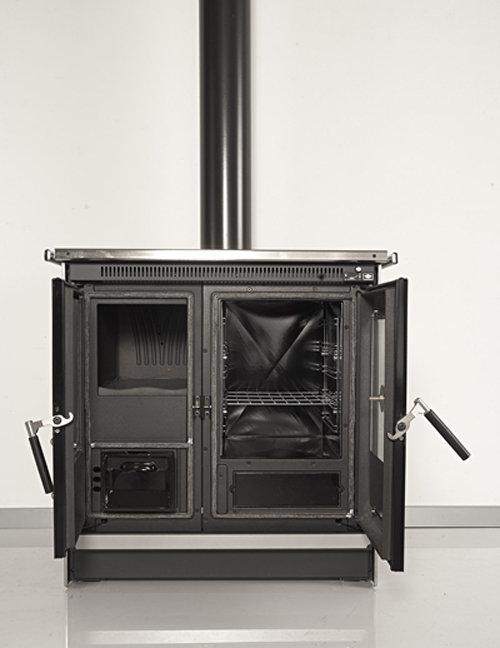

    Magnum is the model of the cookstove. Sopka is the name of the Importer we used to deal with. I believe the Magnum is manufactured by MBS in the former Yugoslavia, (Serbia today) I do not know anything about MBS as a company.
    Looks like they have a new website now which is an improvement over the old one. http://www.sopkainc.com/index.php/product Notice the contact info is the same so it is the same company as the site you posted.

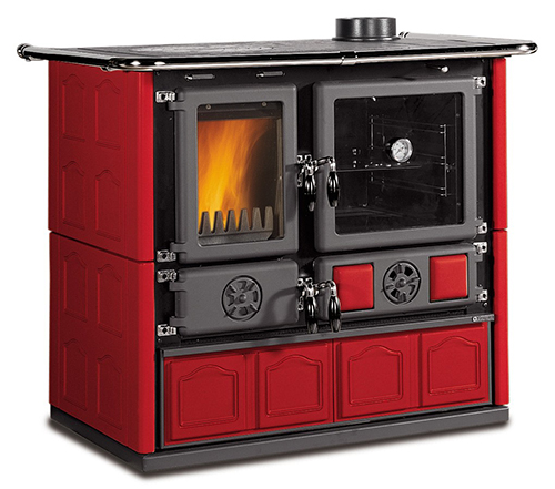

    A similar stove but much higher end in terms of quality would be the LaNordica Rosa, http://www.lanordica-extraflame.com/en/woodburning-cookers/rosa_p8997 but I don't believe they are available for import into North America.
    About 10 yrs. ago I started looking at European cookstoves and had established relationships with a couple Eastern European Importers so we could offer these types of stoves. My understanding is that the Magnums were manufactured in the former Yugoslavia which most folks forget....................... Was behind the "Iron Curtain" until the "Reagan Era" when the wall came down. Early on the stoves were screaming deals at a screaming price, but no UL or EPA sticker.
    Over the years we pretty much came to the conclusion that we'd just as well stay focused on quality and we picked the best European stove line we could find that's stoves were UL listed. We choose ESSE, met the owner of ESSE and the North American Rep and the rest is now history.....at some point we may introduce the LA Nordica line as it is also a leader in the European market.
    Our feedback from the customers that purchased the Magnum and Sopka imported stoves, said once you looked inside at the details,fit and finish it was pretty obvious that the quality was not the same as many Western European Cookstoves. Most customers were happy with the stove as it was pretty, shiny and they could see the fire in the firebox, it also heated and baked fairly well if your area was small and did not require much heat to keep warm. The firebox and oven are kinda on the small side by Western Standards.
    When we were selling them, they were the least expensive stoves we offered at that time. They were never a huge seller as my customers are more concerned with the long term service and support than the short term price. The importer could also not afford to get them tested to be UL listed. This severely limited the market for us as most of customers are concerned about their insurance companies UL requirements. I believe that this has changed and now some stoves have a UL listing now, but you should check with Sopka to be sure if your in the States and need to make sure your insurance company is happy.

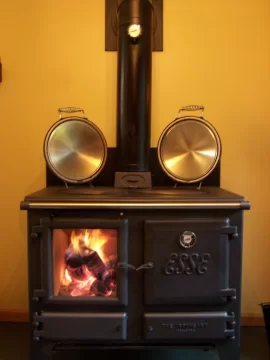

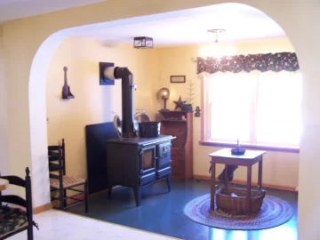

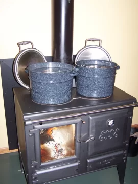

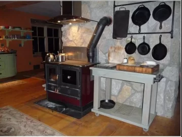

    Love my Esse! Thanks to Obadiah's for coming through with a great price and service! Its right at home in our Farm house.

    It's a real pleasure to have the Esse,,,I love the massive gentle heat ,,plus, you have instant heat anytime you want to bake something or even just warm up some left overs...things I never thought of until we installed the Esse.

    I looked at the Deva in person at a local stove shop,, was like tin compared to the Esse.. Esse has great latch adjustments for the doors and door hinges,,, just details you want . I guess I would say it was like looking at a homeowners stove verses a commercial grade stove.
