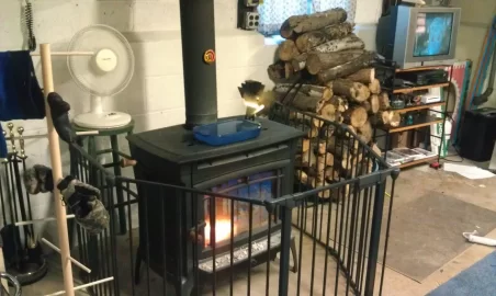

Purchased the new Manchester by Hearthstone on black friday last year, installed and up running mid Dec (after inspection by town). Had insert in previous house for 3 years. When i purchased the stove the dealer said 'why do you want a blower, i heat my entire show room with out one, but if you want one later on i can get you one'. So no blower. The stove is great, my wife actually picked it out, heats the basement and 1st floor great. We live in a split level with the stove in the basement, facing the stairs to the 1st floor family room. To help direct heat upstairs I placed a 12" fan on a stool behind the stove to direct air up the stairs to the rest of the house (see photo). My question is would a $350 blower kit be better at pushing air/heat than the 12" fan? (the eco fan was just for kicks that one day...)

Probably not. Do a little research on both fans. They should both have a CFM rate. Easy way to compare.
There is one advantage to the blower - it will remove heat from the skin of that stove. Your 12" isn't pointed correctly to do that (if you even had that in mind).

Jags is right, you should aim that fan at the top of your stove.

i have moved the fan to hang from the basement ceiling about half way between the stove and the steps up to the family room. moves much more air. still thinking about the blower-maybe this summer when prices could be lower.
