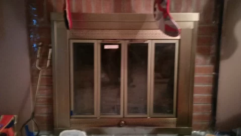

I know there are a lot of Englander owner out there and wanted your input to see if you thought the 13-NC stove would fit in the fireplace vs the 13-NCI insert.
The 13-NC is 25" W x 28 1/4" H (with 9" legs?) X 20 1/2" D
The 13-NCI is 25 1/4" W X 22" H X 20 1/2" D
Current fireplace measurements are 35" w x 30" H (to the lip) x 20 1/2" D. with 17" hearth.
[Hearth.com] 13-NC or 13-NCI
I wanted to get the stove for two reasons 1) cost (649 vs 1099) 2) use the stove in another room later once I can afford to buy bigger insert.
The house is a 1900 sqft colonial but i do not plan to heat the whole house with it yet

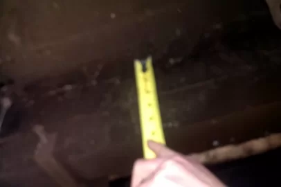

BrotherBart confirmed my fear with the current fireplace design.... Its just too short for a 30 NC.... And maybe too short for the 13 NC as I never thought about how the heat would get past the lip
Talked to the wife about taking out a row of bricks at the top of the fireplace to get 6 additional inches but was met with dismay (to put it kindly).[Hearth.com] 13-NC or 13-NCI
Talked to the wife about taking out a row of bricks at the top of the fireplace to get 6 additional inches but was met with dismay (to put it kindly).View attachment 120090
