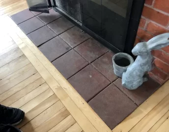

I have a small 1920s-era foursquare house with a large central chimney.
The hearth is divided into 14 equally sized sections that I always assumed were individual 8"x8" terra-cotta colored quarry tiles. Several of these "tiles" are loose, rotate slightly and make a clank sound when stepped on, and they release a small shower of grit onto the basement floor below when they move.
After many years of "intending" to fix this, I finally got around to trying to remove the loose tiles, intending to shim them level with a pit of grout or thin set mortar. To my surprise, I now see the that the hearth and fire place floor appear to be a single (probably) poured piece, and the joints between "tiles" at the hearth are incised, false joints, not true joints between separate tiles. There are no similar joints inside the fire place. The hearth is supported by cantilevered threaded steel pipes which hold up layer of brick and mortar sub floor. Which I think is pretty nifty.
I have two questions for the group:
  • Is this a common construction technique for the era?
  • How can I remove individual "tiles" without damaging them? The "tiles" are loose enough so they move up and down, but they're still locked to their neighbors at their perimeters to the degree that they can't be fully lifted up and out. I'm not excited about getting out the angle grinder and filling my house with brick dust.
See attached photos.

Can you use a dental pic to scrape between the tiles? If you clean the dirt out they may lift out easily.
No idea on how common the construction method is.
Looking at the bricks of the fireplace, they don't look like 1920s to me.
I second using a thin metal tool to scrape the seams to see if you can lift out the top in order to use some mortar underneath to reset them.

As others have said just start scraping between them they will probably come out

We ran into this same issue on a 1928 house. What looked like tile turned out to be solid concrete (a different pour with color). The tile grout lines were evidently cut into the concrete. We used a chipping hammer/chisel, ear and eye protection, and a lot of time to remove the top 3/4" to get flush to the surrounding subfloor.
