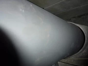

    Lastly... I purchased a new oval to round adapter from Heat-Fab, but there is a 3/8ths gap on each end. I assume I just fill this with stove cement?

    The gap is at each end of the oval opening where the stove pipe goes into the stove. The actual opening measures 9" x5" but the pipe measured 8.5x5. I could not find one that measured 9" online. It fits snuggly throughout but has the gap on each end. Can I fill this with stove cement to seal it up? I'll post a photo tonight.

    Is there any reason I shouldn't fill the small gap with firerope and stove cement between the stove pipe oval and the stove collar?

    There really shouldn't be that much of a gap. Not enough for a gasket to fit in, at least.
    Post a pic.

    Pipe doesn't seem to be in all the way.

    Look at the front. The rolled edge is tight to the stove. Will not go down further.

    The back should be further down.

    I guess I don't understand how. That rib in the the pipe goes all the way around and is right up against the stove collar front and back. The pipe is level, although the first pic looks to be tiped forward. Trust me the pipe oval is about 3/4" smaller than the stove collar.

    Okay. It looked uneven in the pic.

    So do I full with stove cement, stove cement and rope, or go back to drawing board and find larger oval and new pipe. (I already spent 70$ on this pipe and oval adapter). The different adapters are shorter and would need longer pipe to fit correctly.

    I didn't worry about any gap that I had. I screwed the pipe in to make sure it was a tight fit and it worked fine. I have CO monitors next to all my stoves and it never made a peep when the Vigilant was running.
    No harm in filling it with furnace cement, which I have done when the Intrepid was connected. I wouldn't go as far as stuffing it with gaskets, though.

    +1. If you have an adaquate draft, a gap like that shouldn't matter. Gasketing or cement is fine to fill it if you need to, and I certainly would if you install the cast stovepipe damper. Maybe just run it as is and see how it goes. Remember that unlike gas and oil appliances, woodsmoke smells and long before CO becomes a problem, you'll smell the smoke in the house, be coughing, eyes watering etc.
    THere may be any number of other issues w/an old Vig. so run it, see how it goes, report back! Hope for a good season.
