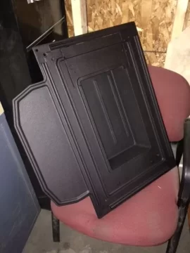

small update. I have some interest on the stove, but everyone wants a left hand side door, so I will be converting it. Not a big deal, other then now its not 100% original. anyway, I test fit the back plate, which will need a little trimming before installation. Also, I have the first layer of stones cut. I really should knock this out this weekend, my wedding is coming up (8/29) and I have 2 more full rebuilds.
on to the pics...
[Hearth.com] 1985 Hearthstone II rebuild
Dont worry, the back plate will receive a coat of black :)
The side plate pictured is for a right hand door, and will not be used.

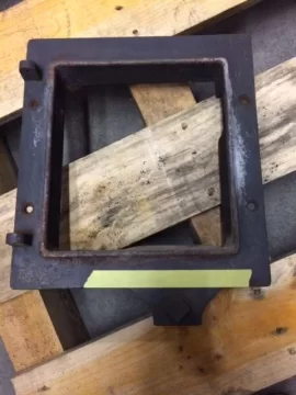

8/22- Side door frame is done, and painted, and bolted to the side legs. I cut the coal shaker stuff out, for a nice clean look.
