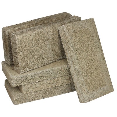

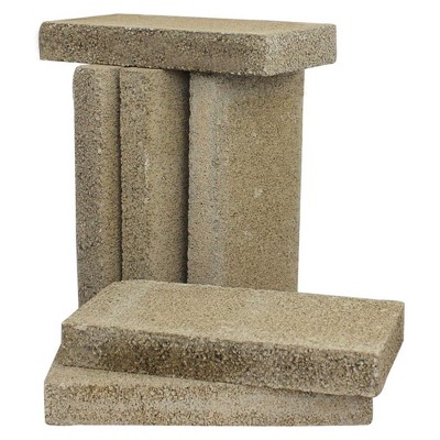

The Super takes pumice bricks. The best price I have found is the US Stove 6-pak. Shop around, the prices are all over the place.
