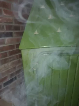

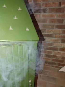

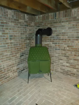

Unsure of its just a draft issue but smoke seemed to be pouring out of places that i feel should have been sealed. Stove was given to me from my brothers old house. Leaked very badly along some of the seems of the top and front angled plate. stove is in basement with 8 inch from the top to a 90 and out the wall to a cinder block chimney

This is very likely a draft issue. Was the chimney thoroughly cleaned and inspected before connecting the stove?
If the stove is disconnected, is there draft at the chimney thimble? If you hold a cigarette or incense stick in front of the thimble, is the smoke pulled into it?
Negative pressure in basements is a common problem. If there is significant air leakage to outdoor on the upper floor(s) that can exacerbate the problem. Leakage can be open windows, unsealed ceiling vent (or doorway) to the attic. Exhaust fans (kitchen, bath, dryer) can also make the problem worse as can a competing appliance like a furnace or gas/oil hot water heater.

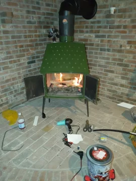

Home was just recently air sealed and re insulated in the attics, local shop just recommend to take a hair dryer and try to preheat the flue, will try that before I try to disconnect and test your way

If the chimney is exterior then it could be a cold chimney issue. It's worth a try to preheat it with a heat gun or hair dryer on high. Some folks put a few big candles in the stove and burn them for 30 min. before lighting.

Also (given draft concerns), how tall is your chimney?
Looks like single-wall stove pipe.

I use a propane torch to preheat the flue if it’s a cold start on a cold day. Works like a charm on a cold day.

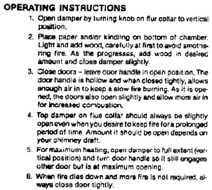

The door handle on this stove is hollow and will admit air depending on its position. Here is how to operate:
